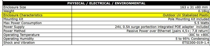

While the datasheet for the Nanostation Loco M2 lists the enclosure as "outdoor UV stabilized plastic", it does not specifically mention it can be mounted outside unprotected from the elements. I used to have it inside behind a window. I moved it to the basement, but the signal is strongly affected. I'd like to move it outside.
If you mounted your AP point outside, how did you do it and how did you protect it from the elements (mainly rain in my case)? Thanks in advance for your recommendations.
The Nano Loco's case is waterproof. I mounted a short (6") piece of 3/4" PVC outdoors on the side of my house and then zip-tied the concave section of the Nano's mount to it. It's been outside for 7 or 8 years. The white case has yellowed somewhat from the sunlight's UV, but it still works flawlessly.
