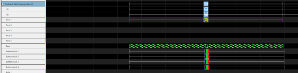

Good afternoon. I am 100% new here and am looking for some assistance. First off, this is my second year doing a holiday light show. I have had relatively good success with it thus far. However, this year I added two new props, one of them being a Pixel Arch with Singing Bulbs from HolidayCoro. The pixels all work, testing on the controller board, controller network connection, as well as xLights. When I began sequencing one of the arches, a rogue pixel (assuming the 1st pixel in the sequence) appeared. How do I rectify this? I am assuming it is something within xLights? It is not a pixel that is at the beginning or end of a physical string (I have checked on the prop itself). Thank you and I look forward to hearing some conclusions.
You can edit the model on xlights, I've had to do this before on a coro santa. You can go to the Model Data under the model settings in the layout Tab and edit the model just make sure you have a good count of the nodes and their positions.
